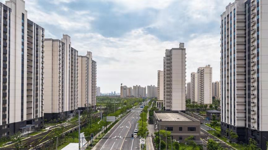

    New Good City Low-Income Housing of Common Property Project
  • detailsa-left2
    Shanghai, China
  • Project Type & Description: Residential buildings, with prefabricated building design
  • Gross Floor Area: 156,169.32 m²
  • Design Institute: Shanghai Longilat Architectural Design & Research Institute Co., Ltd
  • Glodon Products Involved: Glodon BIM design
